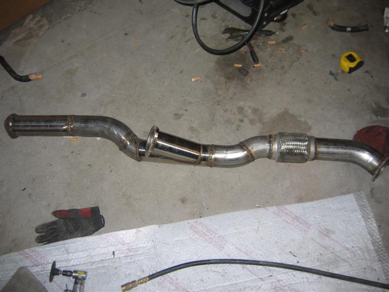

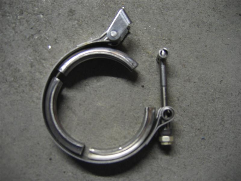

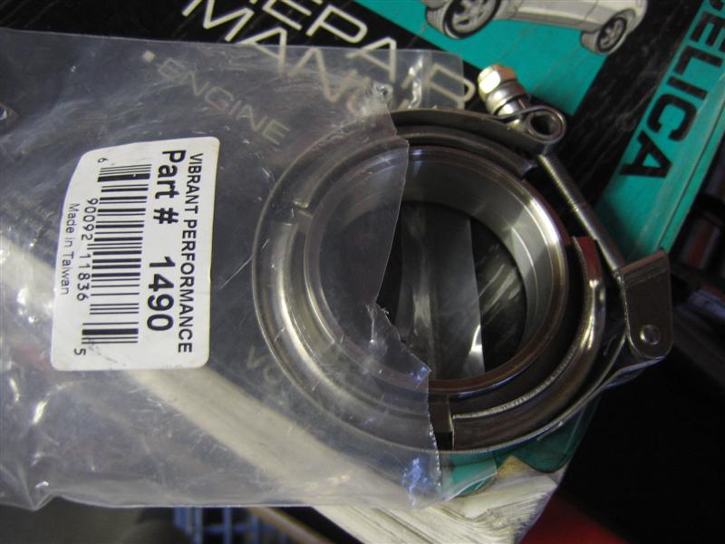

Did you get a good price on the Vibrant stuff? I carry it if you want to check prices with me sometime.

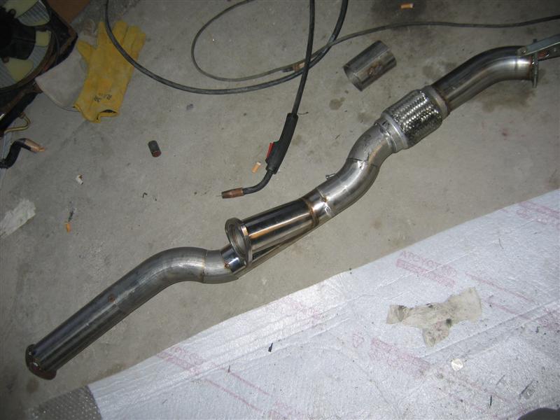

Here is, like promise!
4-2-1 Header with DEI wrap.
OBX SP2

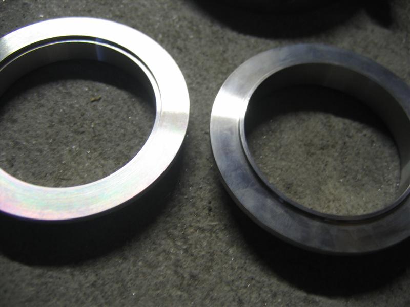

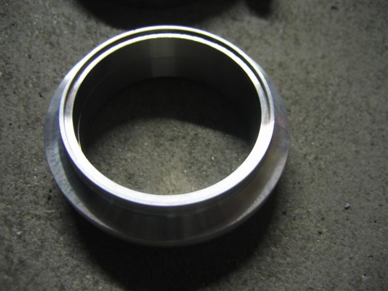

some pics of the header back exhaust i made for batman722 and hurley97's beams swap.
2.5" 304 stainless, mandrel bent, header back, with generic ebay resonator, and magnaflow 14" muffler.
first, the 2 into 1 merge collector from the stock header, with 2.5" pipe massaged to fit"
finished b-pipe
center section with resonator
over axle and muffler
a few installed. sorry, i dont have a lift, so its hard to get pics of the whole thing at once under the car while its on jack stands.

Well....after riding around with an open down-pipe for a year, i figured it was time to put the exhaust together, weld it up, and hang it.
Heres the set-up that i have
Full 3" turbo back exhaust consists of the DP, to a 45* bend and up and over the crossmember to the flex pipe, from there it flows into the QTP electric cut-out i put in. From there its basically a straight pipe all the way back to a 3" Megan muffler.
with the cut-out open it sounds awesome, super throaty and a little more quiet then an open downpipe.
When the cut out is closed the car is almost silent. The meagn muffler does a great job of muffeling the noise, however i wish it was a little more deep, and had some more sound to it.
i love the way its set-up, but it does have a couple flaws. For 1, its pretty low, since i ran it under axle. When my buddy welded it up, we were somewhat in a rush to get out of the shop, and i just wanted it on, so instead of throwing 2 extra bends in the exhaust and staying in that "stock tunnel" we went right under the gas tank and out the back. We bent the sheild up against the gas tank to deflect some of the heat. Other then that is perfect, and im very happy with it.
this is the 45 that bolts to the DP into the flex and cut-out section
And what it looks like on the car...i'll have to get some under-body shots, but you get the idea
