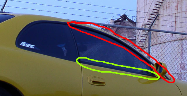

How do I remove these two outside trim pieces:
The bottom one circled in green I can access by removing the door panel...it looks as if it's held in very tightly by plastic clips that need to be pulled back with a screwdriver...does the trim just pull directly up once the clips are pushed away? Also, how do you deal with the large clips on both ends?
As for the top one, I have no idea how it comes apart...anyone know how?

I think the top (red) one is just pushed onto the bodywork, not sure exactly.
The lower (yellow) one is a pain in the neck. It has a couple of push fasteners and its clipped into a couple of brackets inside the door. I tried pulling/levering as hard as I dare without breaking it but it wouldn't come off so I had to mask it up.
Good luck mate.

the top one is held in by screws, that are under the rubber moulding.
the door panel one im not sure about.

remove he door panel and adjust the window so its as for to the inside as possible.
