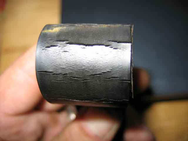

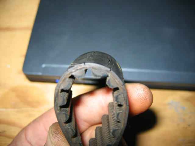

here is a pic of a toyota 5sfe timing belt with ~100k on it..it came outta itchyb's old 5sfe.
this is the reason toyota recommends doing the timing belt every 60k.

i inspected my 60k old belt at 120K on the dot, it can go a couple thousand more miles.
i twisted it back and forth and ran my fingernail over the back of it. the belt wasnt signifigantly glazed and i couldnt feel any cracks on the backside of it.
i wish i had a timing chain instead of a belt.

i pulled the side cover below the valve cover and inspected the timing belt.
toyota 1zzfe, 2zzfe are both using timing chains and have had very very few chain failures considering the large volumes of those engines worldwide.
you cant compare VW to a toyota when discussing reliabilty, thats like comparing a corolla to an evo and saying that toyotas are all slow.
