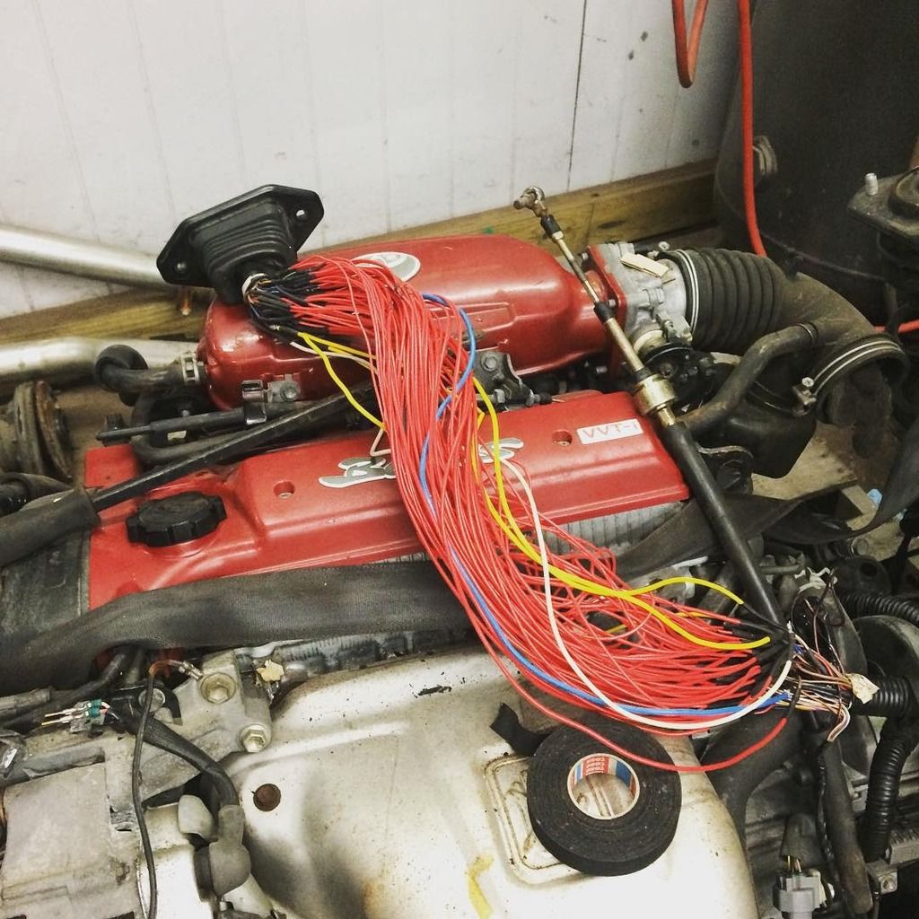

A question about extending the harness... Did you use all the same gauge of wire when you extended it or did you match the wire sizes? I got 16 gauge Primary wire but these look something like 18-22.

just go get some 18 and 22 wire

Lol, yes I did that. The wiring harness is all extended. I can't believe the newb mistakes I made earlier... Learning experience for sure lol
